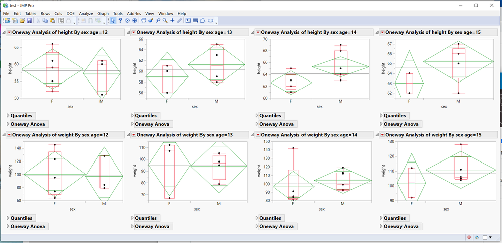

Below is an example that puts the 4 graphs into a single row, and a row for each column specified in the analysis
Names Default To Here( 1 );
dt1 = Open( "$SAMPLE_DATA\big class.jmp" );
// restrict to 4 ages to match the 4 level requirement
dt1 << select where( :age >= 16 );
dt1 << delete rows;
// Create a window to place the output in
nw = New Window( "test", lub = Lineup Box( N Col( 4 ) ) );
// Run the analysis with a By clause
view = dt1 << Oneway(
	invisible,
	Y( :height, :weight ),
	X( :sex ),
	Quantiles( 1 ),
	Means( 1 ),
	Box Plots( 1 ),
	Mean Diamonds( 1 ),
	by( :age ),
	SendToReport(
		Dispatch( {}, "Quantiles", OutlineBox, {Close( 1 )} ),
		Dispatch( {}, "Oneway Anova", OutlineBox, {Close( 1 )} ),
		Dispatch( {"Oneway Anova"}, "Analysis of Variance", OutlineBox, {Close( 1 )} )
// Take the elements from the outout and place in the window
// The display produces all levels of the by across one level
// of by group and then moves onto the next by group.  Therefore
// the displays need to be picked across the full range of outputs
// to get the four grqaphs aligned
numCols = N Items( view ) / 4;
For( col = 1, col <= numCols, col++,
	For( theRow = 1, theRow <= 4, theRow++,
		lub << append( Report( view[(theRow - 1) * numCols + col] ) );
		i++;
Jim
