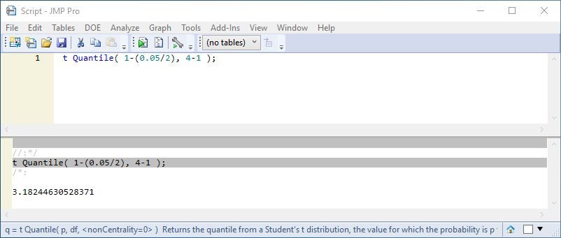

You are calculating a two-sided confidence interval for the mean using the quantile from the t distribution for (1-alpha)% confidence and (n-1) degrees of freedom. The function for this in JMP is t Quantile( probability, df ). Here is the quantile for a two-sided 95% confidence interval for the mean:
I used the script editor and an embedded log but you could also enter it into a column as a formula. This quantile is correct.
If you enter your 4 observations into a column, then select Analyze > Distribution, select the data column and click Y, Columns, then click OK. You will find the 95% CI in the Summary Statistics report.

Re: Calculation of t-distribution, JMP 13
No, of course not.
You enter your data into a JMP data table and then use one of the platforms in the Analyze menu. The confidence intervals for the mean in Distribution, the slope in Bivariate (Fit Y by X), tests in Oneway (Fit Y by X), and all the platforms through the platforms launched by Fit Model will calculate the confidence limits automatically. (It sounds like each of your 'experiments' is a sample drawn for a different population and you want a new confidence interval for the mean, so Distribution will do it for you.)
There is no need for you to look up the t quantile or calculate the intervals by hand.
