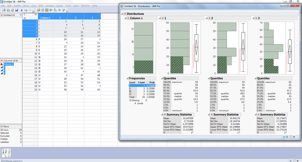

Hello,
I would like to knwo, how the t-distribution is calculated in the programm. The results I got from the programs are different with the results I calculated by myself, with the help of methods, mentioned in various books and scientific researches.
In addition I would like to know, how it is possible to set up an own quantil in the t-distribution. When I make a box plot, I just can change it in the standard normal distribution.

I have no idea what you are talking about.
By 'empty cell' I assume that you are talking about a new row in the data table. If so, you can select Rows > Add Rows or simply click in the first empty cell below the last row and enter a value.
I can't tell if the next statement is related but what are you doing that you get a mean of 18 for data all above 18?
Perhaps if you described, step by step, what you are doing and what informaiton you are examining, we could help. Posting a picture of the data and the JMP analyses would also be helpful.

Re: Calculation of t-distribution, JMP 13
I added a picture below my previous post. But I think I figured out that the programm cant handle distribution with only marked cells. So they are just highlighted within the result of all values given in the chart.
That is not how the analysis works in JMP. Selecting rows in the data table or through interactions with a plot has many uses but it alone does not change the analysis. If you prefer to work this way, It is possible. You need two commands in the platform menu so simply hold the Alt key and then click the red triangle at the top next to Distributions. Select Local Data Filter and Automatic Recalc, then click OK. Select Column 1 and then click Add. Now when you select one of the four levels from Column 1 (I - IV), the distribution analysis of columns 1, 2, and 3 will only use the rows for that group. (You don't need to include Column 1 in the Distribution platform any more because you are using the local data filter instead of the histogram to change the analysis.)
I tried it this way, but the result is not, what I am looking for. There is still the lower and upper 95% mean below every boxplot.
Try this: press and hold the Ctrl key, click the red triangle next to Summary Statistics, then change the confidence level to 0.9 for your desired level. Pressing the Ctrl key will broadcast the next command or action to all of the other objects in the window and they respond in kind if they are able.
Ok, that works very well. Saves a lot more time. Thanks a lot. So far the best option.
