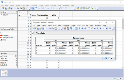

I think this can be done like this example below.
Names Default To Here( 1 );
// generate yield table
dt1 = New Table( "dt1", add rows( 9 ), New Column( "Process", "Character", values( Repeat( {"A", "B", "C"}, 3 ) ) ) );
dt2 = New Table( "dt2", add rows( 9 ), New Column( "Temperature", "Nominal", values( Repeat( {30, 40, 50}, 3 ) ) ) );
dty = dt1 << join( with( dt2 ), Cartesian Join );
For Each( {dt}, {dt1, dt2}, Close( dt, "NoSave" ) );
dty << set name( "yield" );
dty << New Column( "yield", "Numeric", "Continuous", set each value( Random Integer( 0, 1 ) ) );
// tabulate
dty << Tabulate(
	Show Control Panel( 0 ),
	Add Table(
		Column Table( Grouping Columns( :Temperature ), Statistics( Sum, N, Mean ), Analysis Columns( :yield ) ),
		Row Table( Grouping Columns( :Process ) )
Georg

Re: Calculating Yield using Tabulate
// tabulate
dty << Tabulate(
	Add Table(
Georg
MichaelO
Level III
Using the mean makes sense. I can't believe I didn't think of that!
