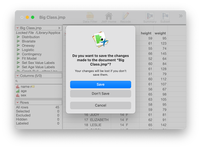

Hi.  I'm wondering if there is a way I can prevent the "Do you want to save..." message when a table is closed?  That is, this message:
Why?  Because I want to allow the user to make changes to the table, but I want to force them to save as a csv because we have other apps that require csv format.  To do this, I'm adding an " << On Close" script:

However, the "Do you want to save..." message still always appears prior to saving the csv.  I really don't want the user to save as both a jmp table and csv file, because then it creates 2 copies of the same doc, which will lead to confusion.
