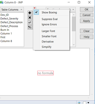

natalie_,
The Formula Editor has a derivative option.  You can access it by clicking the red triangle at the top of the Editor dialog.
Hope this helps.
