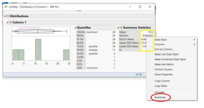

In JMP 14, you could right click on the values in the output to obtain bootstrap confidence intervals.   However, in JMP 15, this no longer appears to be an option.   Does anyone know if JMP removed the bootstrap option completely or if they moved it to some other location?

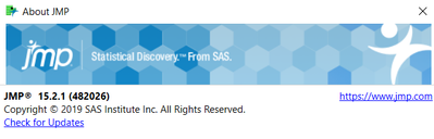

Here's my "about":
It looks the same as yours.   I don't see a difference.

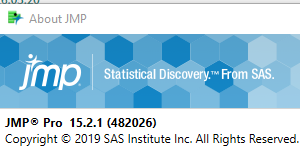

Look at the bold line right below the blue banner, mine says "JMP (R) Pro 15.2.1", and yours says "JMP (R) 15.2.1".  I would email JMP Support.
mdunlap
Level II
Re: Bootstrapping in JMP 15
Oh i see that.
Strange that my university offers a JMP "Pro" Windows  and Mac version.   I installed the MAC version which does have "Pro" mentioned in the "about" and the bootstrap does work.
But, the Windows version does not have "Pro" mentioned.    Maybe I should mention the differences to the IT at the university and see if they can contact JMP about it.
