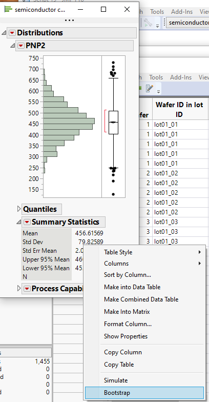

Here is an output from a Distribution Platform in JMP 15.2, and the Bootstrap option is present

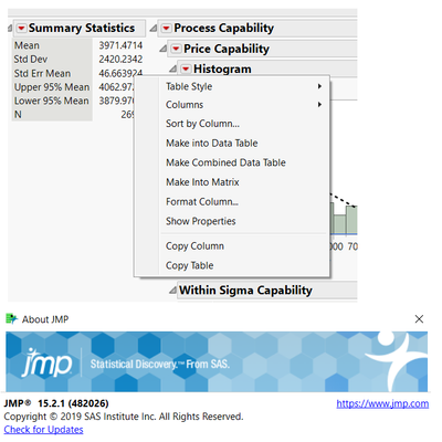

I updated to 15.2.1 and it's still not showing there.

Based on the 'about 'screenshot from your message on DEC 6, 2020 1:10 PM it does not look like you have JMP Pro.  As @txnelson suggested I believe that is the issue. I would make sure you have the windows installer files for JMP Pro and run the install again. If that doesn't work this look like an issue for support.
