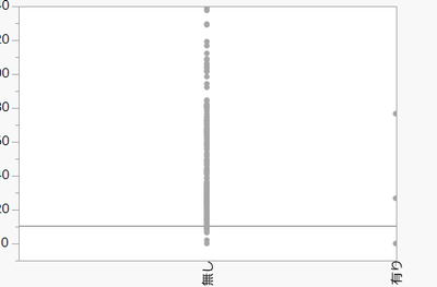

Bivariate Analysis, how to edit graph
The number of the right dates are smaller than left one.
So, as you can see the points are lining on right side and they are hidden.
Could you tell me how to move the position.

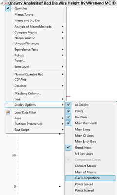

Hi @AKARI ,
To disable the X-axis proportional, you can click the red triangle -> display options -> untick X-axis proportional
Additional reference can be found here
https://community.jmp.com/t5/Discussions/Oneway-Plot-x-axis-spacing/td-p/193419
