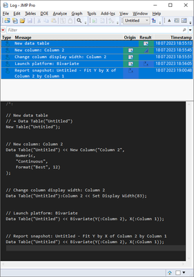

Perform the actions interactively in JMP and let JMP script it
  1. Open JMP
  2. Create new empty table
  3. Create your columns interactively
  4. Use Tabulate/Summary/Distribution/... to calculate means
  5. Use Fit Y by X to create plot (or graph builder)
  6. Try out red triangles in different locations to see where you can get and what type of scripts
  7. If you have JMP16+ check out log (if enhanced log is enabled it has recorded your steps, bivariate plot will be recorded after it is closed)
