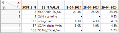

Hello
I have a table and would like the empty volume to be updated to 0
I have written the script to update the column "19-04-2024"
the problem is the name of the column can be changed and I prefer to use column (3) or column (4)
but it doesn't work.
can you please correct the script?
dt << Begin Data Update;
                                    dt << Recode Column (
                                    dt << Column (3),
                                   {Map Value( _rcOrig, {., 0}, Unmatched( _rcNow ) )},
                                   Update Properties( 1 ),
                                   Target Column(Column (3) ) );
dt << End Data Update;
