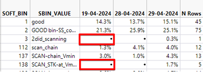

I have a table and would like the empty volume to be updated to 0
I have written the script to update the column "19-04-2024"
the problem is the name of the column can be changed and I prefer to use column (3) or column (4)
but it doesn't work.
can you please correct the script?

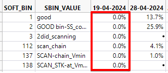

it's something wrong
I tried to use the simple script to change empty volume to 0 in column "19-04-2024"
dt[1::10, 3] = .;
missing_rows = Loc(dt[0, 3], .);
dt[missing_rows, 3] = 0;
but I see the script change not just empty value to 0, the script change 14.3% and 21.3% to 0 too
actually my script is working well, but I don't know how I can change dt :"19-04-2024" to "column 3"
