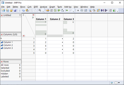

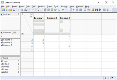

If I have table like this
and I wish replace missing values of column index 1 and 3, I would use
dt << Recode Column(
	As Column(dt, 1),
	{Map Value(_rcOrig, {., 0}, Unmatched(_rcNow))},
	Update Properties(1),
	Target Column(As Column(dt, 1))
and
	As Column(dt, 3),
	Target Column(As Column(dt, 3))
(number inside As Column has changed)
-Jarmo
