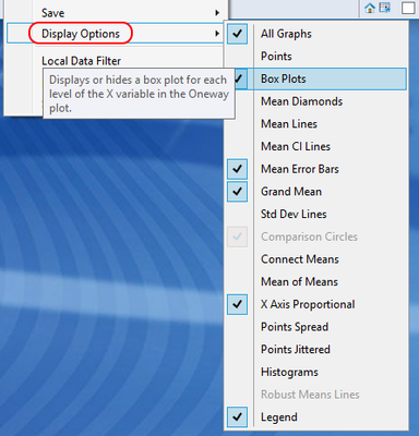

Many platforms include display options under the red-triangle menu:
Click on the triangle, and look to the bottom of the menu for the Display Options, which include box plots, mean error bars, and more:
I hope that helps!

I did check there and did not see a bar chart option. Odd, because I would
think it is the most frequently used format

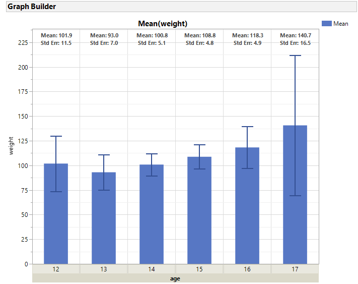

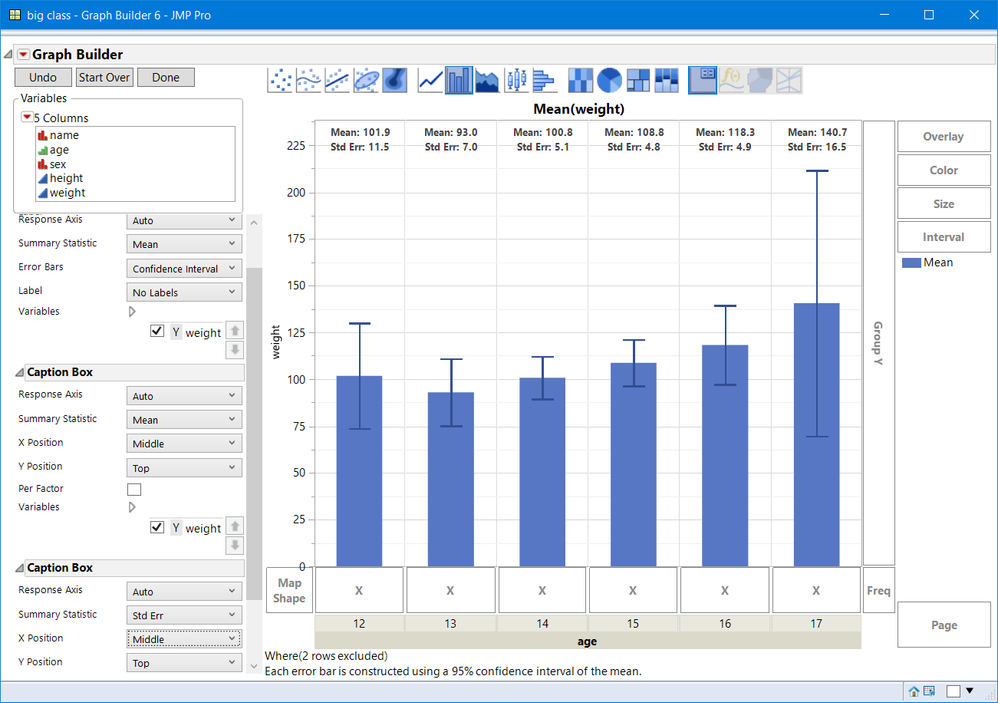

GraphBuilder has an option to display categories, that is, when  an  X- group has all missing values.  That is an option trhat can be turned on or off from the red-inverted triangle menu.   I opened Big Class. JMP and deleted one value in column weight, hence a missing value.  I also randomly selected 2 row right clicked and selected, Exclude.
  • Drag :weight to the Y area
  • Right click in the graph, select Points > Change points to bars.
  • Add two Caption Box: one for Mean and one for Std Err or N or other summary statistics.  To make them bold right click in the graph and select Customize. Then  for each Text, select and chane the font to Bold.
  • Drag :age to the  X-Grouping Area.
  • Right click on the X-Group and select X Group Edge then select bottom.
You will see the graph below.  Now Journal the graph (CTRL + J). Missing does not appear, but messages about exclusions and type of error bar does appear, which I find informative.  If you want to remove that message, type S from the keyboard or from the menu click on the selection tool (the fat plus). Right click on the unwanted text and select Cut or Clear or Delete.

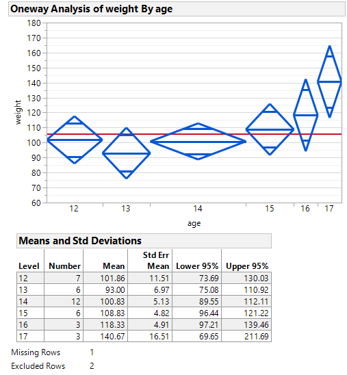

 Note using Fit Y by X there are multiple views of the data. Below is one with X Axis proportional  ( to size, N).  That can be turned off as well.
This shows missing and exclusions.  Again, once journaled, you can select the text and remove it.
