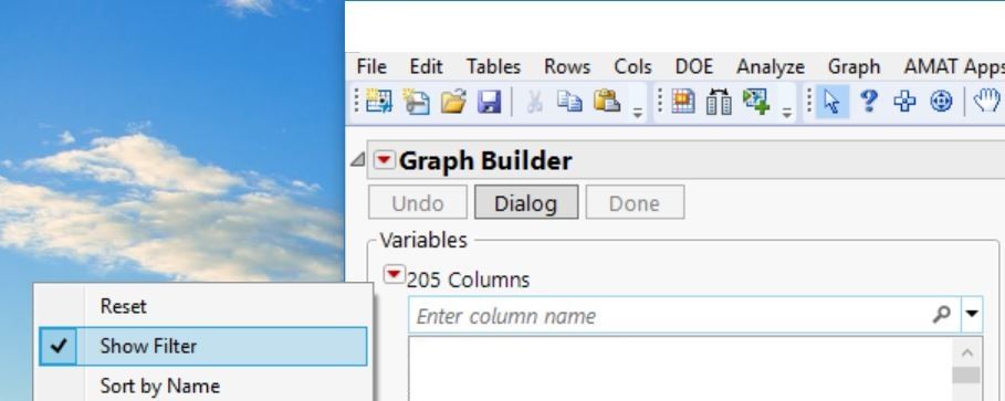

Hi Everyone,
Everytime I deal with huge data which has many number of columns. I use show filter option to look for a particular column but this show filter option I have to activate everytime and in every window. Is their a way I can activate it permanantly or if their is any Add-In available?

Re: Automatically shows Show filter option in every window
I don't know how this can be done without us changing JMP itself, or by creating an addin that includes a custom launch script for every platform.
I would like to ask a couple of questions to better understand.
1. Are you looking to automatically add a local data filter or a global data filter?  The global data filter will affect all platforms, while the local data filter will be specific to the window(platform) being launched.
2. Even if you add a filter automatically, you will still need to configure it before it is useful. For example, you would need to pick what column(s) to filter. Is that OK or would you like to be able to preconfigure the filter too?
I'm updating this reply, because I think I now know what you mean by "filter". You want to automatically add a filter to the column selector, right?  This has been requested and is being worked on for JMP 15. Unfortunately, I don't think there is a way to do it in earlier versions.
Rajat
Level IV
@John_Powell_JMP
Thanks John for your help.
Yes, I want to automatically add a filter to the column selector.
hlazar
Level III
I would like to add my support for this feature. When going into any column dialog option whether a fit model, analysis, graphing, table etc you have to click the red triangle and click show filter. Then click into the entry line and type what you want. This used to be on by default for a simple graphing. I know that JMP has expanded this option for other dialogs but hopefully they can just allowed to be always shown by some preference flag.
