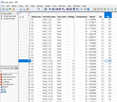

Normally, I keep data in tables like this, where each line is a bunch of metadata and there is a single readpoint:

The tall table is way more versatile, I can do graph builder or tabulate on it and have the best experience, with filters and dragging and dropping and graphing “result” in many ways.
What I want to do is use the “spec limits” which is present as metadata in the tall table.  I can and do extract the spec limits into a table, and apply it to a data table, but that only works for the wide table.  Each unique trial might have unique limits so I can’t just save 1 upper and lower limit to “result”.
