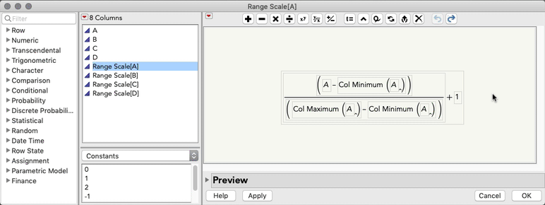

Hi @bordini,
If you're okay with an interactive solution, using Cols > Standardize Attributes will allow you to standardize the formula across your 200 new columns, and will, importantly, allow you to substitute the column references used in the formula. Here's a link to the documentation that has an example of standardizing a formula.
In your case, you can also take advantage of JMP's Instant formulas to make the initial Range columns. Then, use Cols > Standardize Attributes (or right click column header > standardize attributes) to add the +1 to each column, while preserving the unique column references in each formula column (which is what Substitute Column Reference will do). See the video below for a quick demonstration.

//Edit: I missed the square root part. You can add that when you're editing the formula. Just select the outermost formula container and click the root button in the toolbar:root.gif

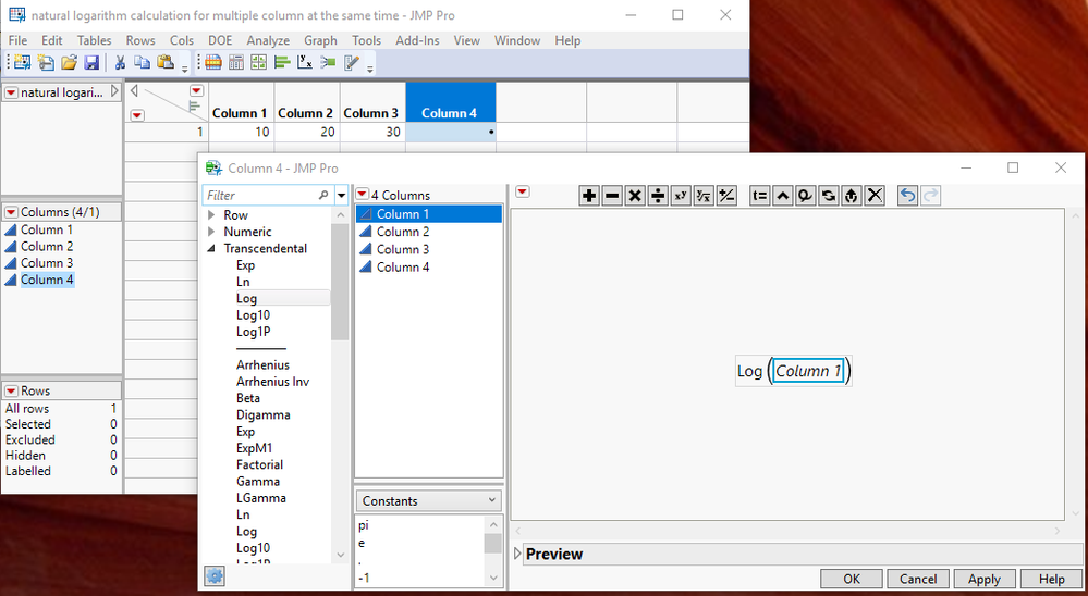

I also have similar issue. I want to calculate natural logarithm on 10 different columns. But I want to see these calculations on new columns. For example as shown in jmp file. There are 3 columns. I want to calculate their natural logarith on 3 new columns. How can I make it easily. 3 column not a big size. But when you have 20 column it is difficult to apply the same formula for 20 column.
could you please help on this?

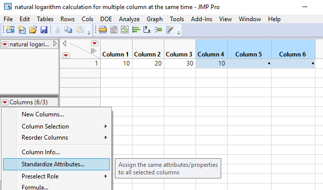

  2. Create the number of new columns required, that you are going to want to replicate the formula forcopy2.PNG

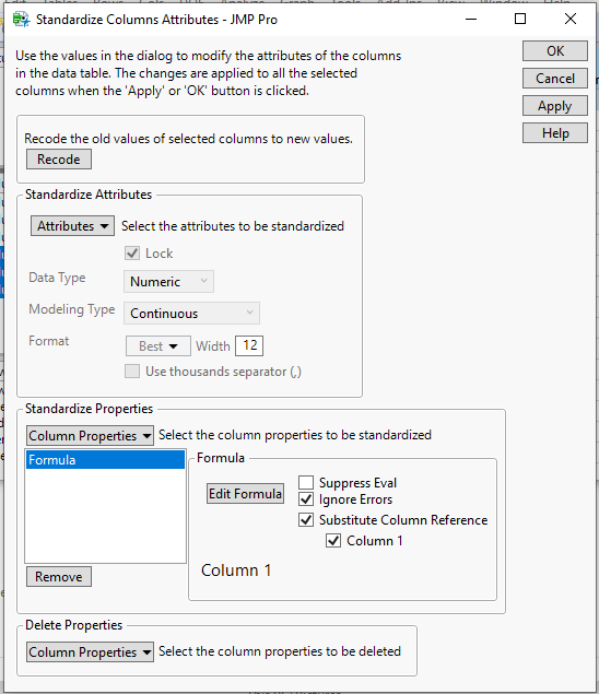

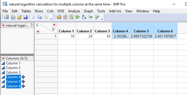

  3. Select all of the columns, including the first column that already has the formula, and then from the red triangle in the columns panel, select, Standardize Attributescopy3.PNG
  4. In the Standardize Attributes dialog window, click on the down arrow for Column Properties and select Formula.
  5. In the expanded window, with the Formula information in it, select the Check Box, "Substitute Column Reference"                                      copy4.PNG
