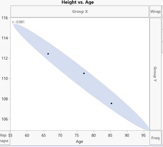

When I try to find correlation between Age and Height  by using multivariate analysis R2=0.9807

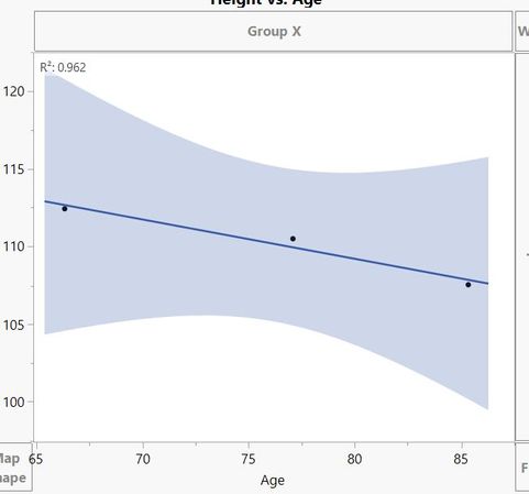

When I apply the same thing by using Graph Builder R2=0.962
What is the reason of this change. This difference will be increase based on results.

I verified the Pearson linear correlation coefficient = 0.9807 from Multivariate with Bivariate and by hand. I do not know how the estimate provided by Graph Builder is calculated. You might send this example to JMP Technical Support ([email protected]) for investigation. Please report here what you learn.

I think you are confusing the Pearson correlation coefficient (r) with the Coefficient of Determination (RSquare).
From Fit Y by X, Multivariate, AND Graph Builder, I get the same value for r, which is -0.981. I have included the Graph Builder report that shows this in the upper-left of the graph.

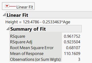

If I fit a linear regression line to the data I get an RSquare of 0.962 from both Graph Builder and Fit Y by X.
Graph Builder report for RSquare.
