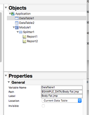

Screen Shot 2018-02-27 at 9.30.22 AM.pngThe Location option is down at the bottom.

This worked!! Thank you so much! I was at a dead end on finding a workaround, mostly because I thought I couldn't see the script that was creating the application anymore. When my application got large enough (60+ platforms with 28+ local data filters and the display elements to hold them all) the "save script" option seemed to just be giving me the custom script portion of my application. It turns out it was just putting all of the Allocate function onto one line. When I hit reformat script it revealed the hundreds of additional lines. This isn't necessarily a bug I guess, but I thought you might want to be aware of it.
When I followed the steps you suggested everything is working properly. I hope this gets fixed in future iterations though, as I will need to create the whole application before going back to the script to edit the filters to be correct.
Jeff_Perkinson
Re: Application with Multiple Data Table and will not create local data filters correctly
I can confirm that this issue will be addressed with JMP 15.2 and beyond. Multiple local data filters in an application will maintain their connection to the appropriate data table.
-Jeff
