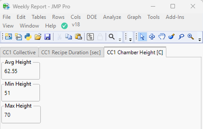

Hi,
I have never created a report bigger than lineup boxes and creatively just arranging things in a 2D box. I have a much larger dataset I want to create an interactive HTML output. My original design was a TAB report with a sub tab system. Say 3 TABS with 3 sub TABS and each sub tab having 3 display panel. My hope was to invoke a function for every plot I needed. The entire report will share several plots.
I tried to make this TAB report from an external structure file. I had not the skills to perform this. My biggest problem is not the report structure, is adding plots to it. The example below is a lame attempt at this with a function call. The problem is I need to subset a few tables and close them which make it problematic. I need a way to build a tab and sub tab report and pass plots to it.
txnelson:  Edited the entry, taking the listed JSL and placing it into a JSL display box using the "JSL" icon

txnelson
Re: Appending Charts into TAB Report
Here is a simple example using JSL to build a disply with Tab Boxes and Panel Boxes.  Look in the Scripting Index for more examples
New Window( "Weekly Report", tb1 = Tab Box( "CC1 Collective" ) );
tb1 << append(
	tb2 = Tab Page Box( "CC1 Recipe Duration [sec]", vlb1 = V List Box() )
tb1 << append(
	Tab Page Box(
		"CC1 Chamber Height [C]",
		V List Box(
			Panel Box( "Avg Height", tbAvg = Text Box( "" ), ),
			Panel Box( "Min Height", tbMin = Text Box( "" ), ),
			Panel Box( "Max Height", tbMax = Text Box( "" ), ),
vlb1 << append(
	dt << Distribution(
		Continuous Distribution( Column( :Height ) ),
		Nominal Distribution( Column( :age ) )
tbAvg << set text( Format( Col Mean( dt:height ), "fixed dec", 7, 2 ) );
tbMin << set text( Char( Col Min( dt:height ) ) );
tbMax << set text( Char( Col Max( dt:height ) ) );
Jim

txnelson
tb1 << append(
tb1 << append(
	Tab Page Box(
		V List Box(
vlb1 << append(
	dt << Distribution(
Jim
