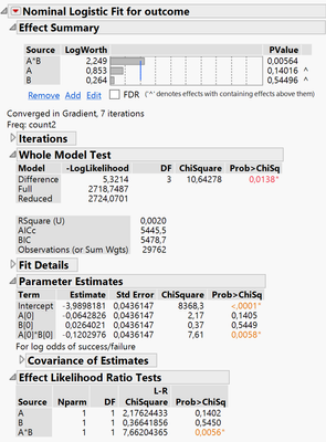

Here we have a classic 2-factor 2-level factorial design which we can analyze using Nominal regression/logistic regression.
Analysis shows that only interaction is significant :

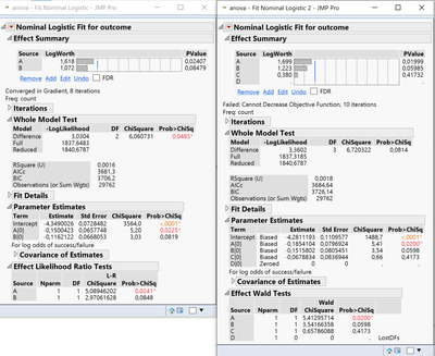

However, if we transform this data as if there were 4 factors A1, B1, C (A1*B1), D (A0*B0),
then we will see that main effects are significant.

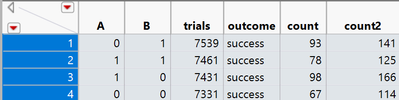

Datasets are in attachments. These results are from real experiment.

You do not really have four factors. Your construction over-specifies the model, so JMP arbitrarily zeros the last 'factor' and indicates that the first three are biased.
The equivalent to two two-level factors would be one four-level factor, not four two-level factors.

Yep, as Mark says...you have 3 degrees of freedom in 4 treatments.

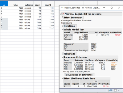

I am sorry.
I have corrected the file to 1-factor 4-level. Now it shows that level A (which is factor A) is significant:

Why are you doing this way? It is more informative to treat this case as two independent factors that might interact in the effect of the response. The original linear predictor with A + B + A*B makes the most sense.

If we look at treatment A1 B0 it has the highest success rates for both count and count2.
Interaction A1 B1 has the lowest success rates if we don't include the control A0 B0.

That's why I looked at it as 1-factor 4-level, and it supported my assumption that A is significant.

I haven't looked at your data, but it appears the effect of A depends on B (or B depends on A).  This we call an interaction effect.  The interaction has greater effect than the main effect by itself.
