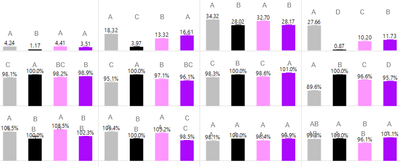

Does anyone have a script to take data from the Fit Y by X analysis tool and add the connected letters report to the table itself?
I am doing this manually in powerpoint, but I have a lot of data to analyse, so any tip or trick would help.
Thanks
I am looking for a result that looks like this, or close.
This was generated by adding the letters one by one onto the graphs, but it is not sustainable long term with the amount of data we are dishing out!
Thanks for your help!

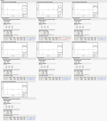

Fit Y by X and then broadcast the Tukey analysis:

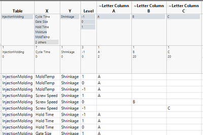

Then use "Make combined data table" to save out the levels and the letters:
Concatenate them into one column then use Join or Virtual join to get them back to the main table and use that new column as your label in graph builder?

Broadcasting is "basic" technique in JMP, you can do it by holding down ctrl when you make selections. In JMP18 you can also just use the "highest level" outline boxes red triangle and it will perform the action on all the by variables,  Using JMP > JMP Reports > Group Platform
