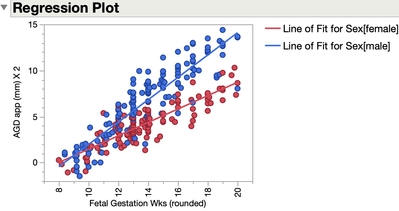

Thanks Byron. For most of my data, that raw regression does not fit the model and having soughte statistical advice, box-cox transformation sorts this out. However, the scales are not the same.

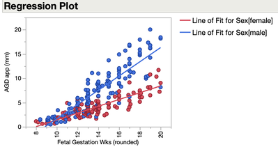

This is a screenshot of the raw regression

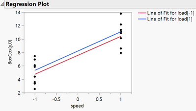

and here a screenshot of the box-cox transformed regression
its clear that the y-axis tick labels are directly based on the transformed data which no surprise. But there seems to be no way to simply instruct JMP to label the ticks with untransformed values. This is why I mentioned the matter of when doing log transformed plots one can select to show the non-transformed values and what happens is the ticks then move to the classic visualisation of a log scale, rather than being equally far appart but labelled with log values.
So my question is around tick labelling not aorund using box-cox transform.
These graphs, with a little tweaking are perfectly publication quality without me having to spend hours messing aroubnd with the very clunky and unintuitive graph builder.

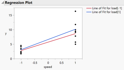

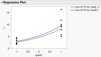

I have my model, which for the special case of a single continuous variable, or one continuous and one discrete (as here) is shown in the Regression Plot outline.

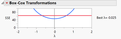

In this example its reasonable apparent that variance increases with speed and this can be improved with a Log transformation to the response.  This is confirmed by evaluating Box Cox transformations ( λ = - 0 is equivalent to a log transform).
For convenience of illustration I will take the log transform rather than λ = -0.025.
Step 2
From the Box Cox transformation red triangle I can refit with a transform and specify the λ value.
The new model looks like this:

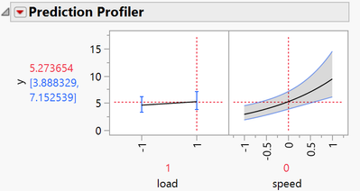

It is linear with respect to the transformed response.  It is clearer to understand the model by looking at the profiler, which shows the y-axis in the un-transformed units:
What I believe @Grumpybaldprof is asking for is the profiler curve on the regression plot. I can make this more explicit:
Step 3
This time I return to the Fit Model platform and specify a Log transformation to the response variable.
Now I get the following Regression Plot :
This I think is what @Grumpybaldprof is looking for.

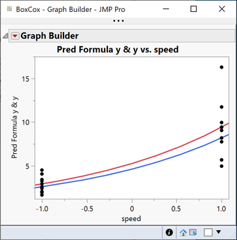

Using graph builder - well it's not the easiest thing to do, let alone describe so I will just give a screenshot to show it can be done
-Dave
