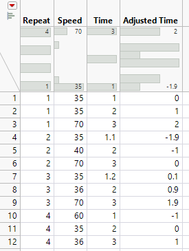

Names Default To Here(1);
dt = New Table("Untitled",
	Add Rows(12),
	Compress File When Saved(1),
	New Column("Repeat",
		Numeric,
		"Continuous",
		Format("Best", 12),
		Set Values([1, 1, 1, 2, 2, 2, 3, 3, 3, 4, 4, 4])
	New Column("Speed",
		Numeric,
		"Continuous",
		Format("Best", 12),
		Set Values([35, 35, 70, 35, 40, 70, 35, 36, 70, 60, 35, 36])
	New Column("Time",
		Numeric,
		"Continuous",
		Format("Best", 12),
		Set Values([1, 2, 3, 1.1, 2, 3, 1.2, 2, 3, 1, 2, 3])
dt << New Column("Adjusted Time",
	Numeric,
	"Continuous",
	Formula(
		If(Row() == 1,
			//Find rows with speed of 35
			speedRows = Loc(:Speed << get as matrix, 35);
			//get repeats for 35 rows
			repeats = :Repeat[SpeedRows];
		//time for first 35mph for current rows repeat
		curTime = :Time[Loc(repeats, :Repeat)[1]]; //adjusted time
		:Time - curTime;
