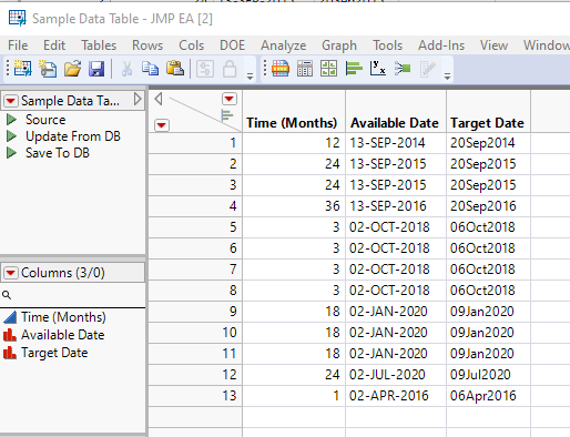

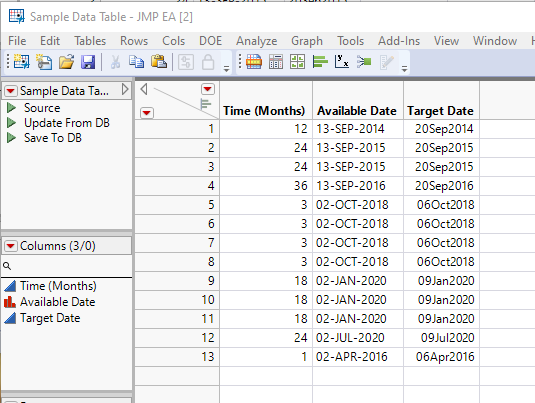

I have a JSL script that periodically pulls data from an Access database.
The access database contains a date column "Available Date" with a dd-Mon-YYYY (E.g., 12-APR-2018) format. What I am trying to do, is create a new column "Target Date" in JMP that adds x number of days to the date in "Available Date" for each row.
For example: In the image below, the Target date is equal to Available date + 4 days. I am trying to automatically calculate the Target date based on the Available date. The number of days is based on the "Time (Months)" column.
This is what I've tried so far, which obviously does not work. I think I need to convert the "Available Date" column to a numeric data type, then add the number of days & convert back to Character?

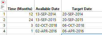

Re: Adding x number of days to a Character Date column (dd-Mon-YYYY)
The attached table adds 4 days to your available date column to get the target date.  Steps:  change the data type for available date to numeric/continuous with appropriate date formatting; then use the Date Increment function to add 4 days to the available date, finally change the formatting for the resulting target date column to match what you used in the available date column.
One additional note - in your example, it looks like you added a week (7 days rather than 4).
