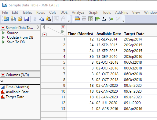

For example: In the image below, the Target date is equal to Available date + 4 days. I am trying to automatically calculate the Target date based on the Available date. The number of days is based on the "Time (Months)" column.

Unless there is a real reason to keep the Target Date values as a character column, I suggest you convert it to a JMP Date column.
Names Default To Here( 1 );
dt = Current Data Table();
dt << new column( "Target Date", format( "ddmonyyyy") );
for each row(
	if( :"Time (Months)"n <= 3,
		:Target Date =
			Informat( :Available Date, "ddmonyyyy" ) + In Days( 4 ),
		:Target Date =
			Informat( :Available Date, "ddmonyyyy" ) + In Days( 7 )

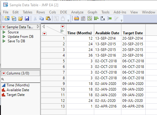

If the output format needs to be exactly as the input data format is, the following will get that accomplished
dt << new column( "Target Date", character );
monthList = {"JAN", "FEB", "MAR", "APR", "MAY", "JUN", "JUL", "AUG", "SEP",
"OCT", "NOV", "DEC"};
for each row(
		temp = Informat( :Available Date, "ddmonyyyy" ) + In Days( 4 ),
		temp = Informat( :Available Date, "ddmonyyyy" ) + In Days( 7 )
	:Target Date = Substr( "0", Length( Char( Day( temp ) ) ) ) ||
	Char( Day( temp ) ) || "-" || monthList[Month( temp )] || "-" ||
	Char( Year( temp ) );

The attached table adds 4 days to your available date column to get the target date.  Steps:  change the data type for available date to numeric/continuous with appropriate date formatting; then use the Date Increment function to add 4 days to the available date, finally change the formatting for the resulting target date column to match what you used in the available date column.
One additional note - in your example, it looks like you added a week (7 days rather than 4).

Re: Adding x number of days to a Character Date column (dd-Mon-YYYY)
This is excellent, exactly what I was trying to do - and so simple! Thank you for the help. I will leave it in the date format.
