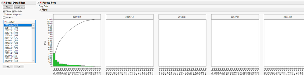

  2. After creating this stacked table, I want to get the pareto chart for each lot. I would usually do that by adding lot to x grouping and then adding a filter by lot to the chart. But this still leaves all the empty graphs for other lots (see below screengrab). How can I cycle through the lots like I can do it in other charts made in graph builder?

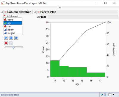

Does the column switcher do what you want?  Here I created a pareto plot of a single variable in the big class sample data, then added the columns switcher using the icon indicated below to swap it out with any other column.  Now clicking any column in the columns switcher list updates the plot.

For Item 2, I don't think you need to add the lot to the x grouping. You should be able to get what you want with just the data filter.
