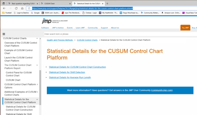

Re: Basic question regarding CUSUM SPC Charts in JMP
I did check out the JMP help
https://www.jmp.com/support/help/en/16.1/#page/jmp/statistical-details-for-cusum-control-chart-const...
for CUSUM. What I found was:
  • T is the target of the process
  • σ is the standard deviation of the process
Am I missing something?
