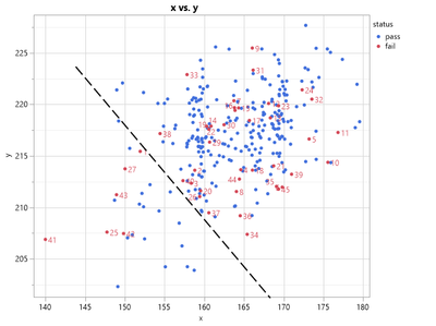

Hi,
I have the following data set below where red data points are some fails that I would like to screen out. Right now the way I am doing this is roughly calculating a trend line (see image below) and finding its equation. Then I create a new column and use JMP formula to basically check if data point is below line and if it is it updates the new column with a 1 and if it is above it marks new column as a 0. This is a pretty manual process and I was wondering if there was a way you could draw a line in graph builder the would autogenerate its equation and select all units below the line and if possible also create a new column?

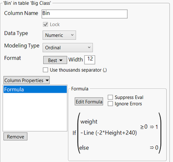

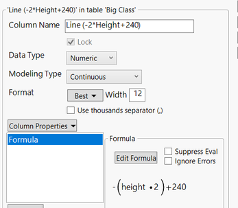

I created a column "Line" with a line function, created another column "Bin":

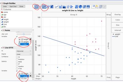

the graph shown below:

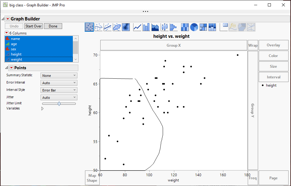

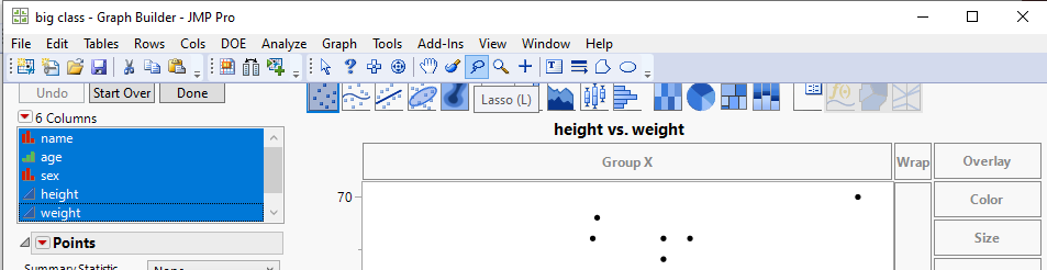

  2. Go to your graph and then select from the tool bar, the lasso toollasso1.PNG
  3. Use the lasso selection tool to capture all of the data points you want declare as bad data pointslasso2.PNG
  4. Note that all of the rows in the data table that are associated with the selected point, are selected and the value in the new bin column has been set to 1.lasso3.PNG

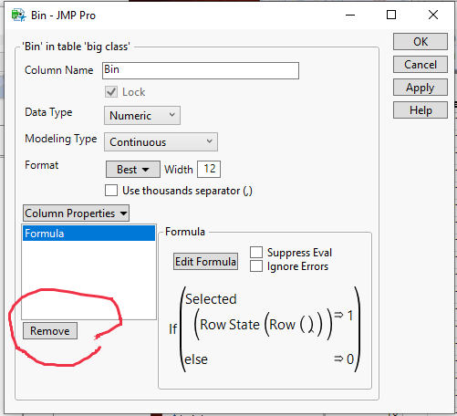

  5. Now right click on the Header for the bin column and select Col Info
  6. In the Col Info window, click on the Remove button to delete the formula, thus turning the bin values into static valueslasso4.PNG

Re: Adding line to split data on graph builder
To plot the line, put both columns "weight" and "Line" on the Y axis. Then select both Scatter plot and fit line plot from the tool bar, uncheck Y Line under the "Point" and Y weight under "Line of Fit" on the left option bars. Please see screen shot below. thanks. ZF
I was not aware of this functionality in Graph Builder thanks! I was able to add the line and simplify my workflow for this
