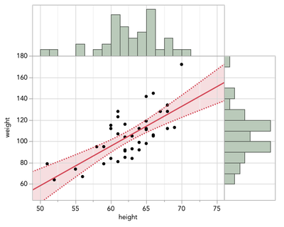

Adding histograms, boxplots or densities next to axis in the graph builder
Is there a way to add histograms, boxplots or densities next to axis using the graph builder in JMP 14?
For example:

Hi @FN ,
I really love these kinds of plots. You can do this very easily in Fit Y by X by using the Red Triangle > Histogram Borders option: FitYbyX.pngFitYbyX.png
If you wish to do this in Graph Builder it will take more steps. I'm happy to write these out for you, but if Fit Y by X does what you need that would be my suggestion.
Julian

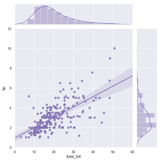

Re: Adding histograms, boxplots or densities next to axis in the graph builder
See the presentation  by @scwise - plot #6 for Marginal Plots shows how to do this by creating a dummy variable in the table.  This helps to create the trellis layout, and then the plots visible in each panel can be customized using right-click.

Hi @FN ,
Julian
