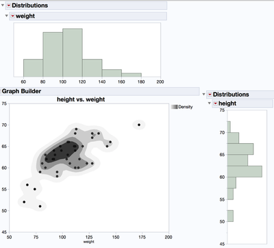

Re: Adding histogram borders to Contour Plot
I used Application Builder and obtained this view combining Graph Builder and Histograms to mimic what I think you were referring to in the Fit Y by X platform.
Thanks LouV. This is a nice solution.
I guess, I was wondering if there was a way to add panels/frames within a platform without using ApplicationBuilder to combine them using JSL.
