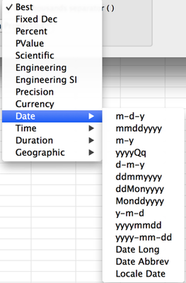

I am having some issues with creating a clolumn of dates.  For example, entered 01/2010 and 02/2010 in the first two cells of a column.  I then highlight the two cells and right click.  Then I select "Fill" and "Continue sequence to..." and then select line 65.  This seems to work well until I discovered that a month somewhere in the column is skipped!!!!  What is up with that?  Is there some sort of bug?  Repeated trials of this produced the same results in different columns, though different mopnths are skipped in different columns. Data Type is Numeric.  Modelling Type is continuous, and m/y is selected

The format of "m-y" does not exists. When updating the formula to the format shown below, it works well.
Date Increment(Informat("1/2010", "m/y"), "month", Row() -1)

Sorry for the confusion. I think it's a localization issue/feature. For me "slash formats" don't exist.
