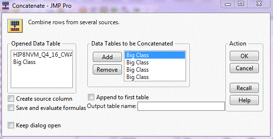

Go to
     Tables==Concatinate
There you can specify to concatinate your current data table 3 times concat.GIF
Jim
