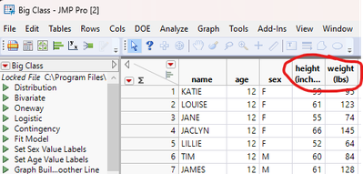

Here is a simple example:
Names Default To Here( 1 );
dt =
// Open Data Table: Big Class.jmp
// → Data Table( "Big Class" )
Open( "$SAMPLE_DATA/Big Class.jmp" );
colNames = dt << get column names( continuous, string );
For Each( {col}, colNames,
	If(
		Contains( col, "hei" ),
			Column( col ) << set property( units, "inches" ),
		Contains( col, "wei" ),
			Column( col ) << set property( units, "lbs" )
Jim
