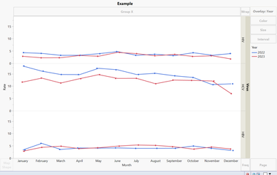

I am using graph builder (JMP 17) and have almost what I need. But I need to add a reference line.
This first image ('example') is what I currently have (I need all 3 viruses in 1 graph with lines and dots for the rates for both years).
BUT, I need to add a reference line for each virus so that it looks like 'example with ref line' (below).
I don't know if it is possible. But essentially, I am trying to get a reference line to show up for each one my y-groups. I can use JSL if someone has something that will work using scripts.

patriciafm811
Level III
Re: Add reference line to Y-group axis
The blue and red lines are my data, but I want to add in a CDC line (which is only available for the year and not monthly like my data) as the green line.

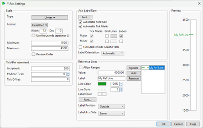

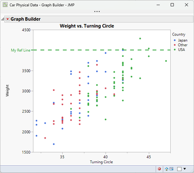

pmroz
You can add the horizontal line in Graph Builder.  Double-click on the Y axis and put a value in to the reference line section.
patriciafm811
Level III
But I need to do this for the Y-Group, not the Y-Axis.
