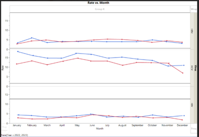

Hello,
I am using graph builder (JMP 17) and have almost what I need. But I need to add a reference line.
This first image ('example') is what I currently have (I need all 3 viruses in 1 graph with lines and dots for the rates for both years).
BUT, I need to add a reference line for each virus so that it looks like 'example with ref line' (below).
I don't know if it is possible. But essentially, I am trying to get a reference line to show up for each one my y-groups. I can use JSL if someone has something that will work using scripts.

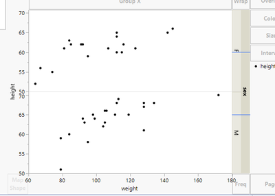

Not sure anymore what lines we are plotting here
Names Default To Here(1);
dt = open("$SAMPLE_DATA/Big Class.jmp");
gb = dt << Graph Builder(
	Variables(X(:weight), Y(:height), Group Y(:sex)),
	Elements(Points(X, Y, Legend(11)))
fbs = Report(gb) << XPath("//FrameBox");
lines = {60, 65};
For Each({fb, idx}, fbs,
	fb << Add Line Annotation(Line({478, (192 / (70.76 - 50)) * (70.76 - lines[idx])}, {478 + 42, (192 / (70.76 - 50)) * (70.76 - lines[idx])}), Color("Blue"));

Attached is the data file. I only need 2022 and 2023 in the final graph.
This is what it should like (but instead of gray lines, they are green, and actually in there instead of just drawn in manually at a guess). The line for HIV is 12.7, HCV is 1.6, and HBV is 0.6.
