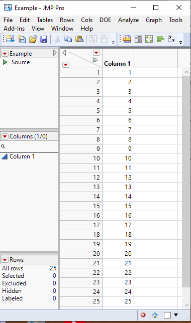

I am a bit confused.  Given the below table
Your script creates
Which is what my understanding is what you want.
Your script creates
