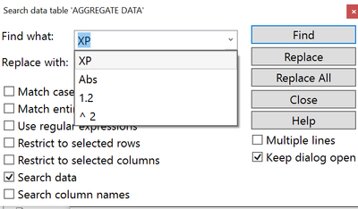

I frequently use the Search/Find/Replace (Edit > Search > Find) in data tables and scripts and even reports and journals, it is very useful.  But one feature is that this tool retains the history of the terms you have used for search and/or replace.  You will see them as a drop down in the dialog as shown below
There are times, however, where you don't want to retain the search history and/or don't want to use the search history.  I have put in Wish List item on this (see Clear saved Search/Find/Replace ), but here is a quick way to remove the search and replace history, using the following script:

I checked and this works on the Mac, also.
