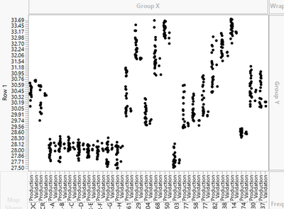

I simply use variability chart of graph builder.

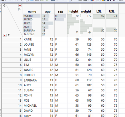

basically, each subject has production results and validation results. Each of the subjects has its own control limits -LCL and UCL.
Thank you,
A.
jthi
Re: Add Control limits to each group in a variability chart
Where are those limits stored? In the same table as measurement results with each group having their own limit? Different specification table? In some other data structure?
I assume they are stored in the same table in their own columns.

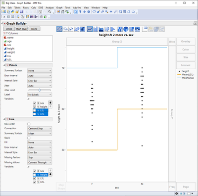

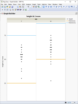

You can do something like this fairly easily in graph builder by disabling/enabling correct variables (columns) for two separate plots while having the value + limit columns in Y-axis
If you were to move groups to X-group instead of X-axis you can get this

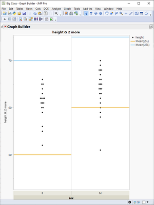

or you can move the X Group edge to bottom
