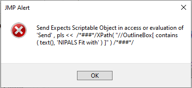

@ih: When I try your way with my example, I get the error message:
I'm calling the PLS using
pls = Partial Least Squares(
		Validation( :Validation ),
		Initial Number of Factors( 15 ),
		Centering( 0 ),
		Scaling( 0 ),
		Fit(
			Method( NIPALS ),
			Distance Plots( 1 ),
			Diagnostics Plots( 1 ),
			Overlay Loadings Plots( 1 ),
			VIP vs Coefficients Plots( 1 ),
			T Square Plot( 1 ),
			Correlation Loading Plot( 2 ),
			Overlay Coefficients Plots( 1 )
because I need the PLS dialog to prompt for X and Y.
txnelson
Re: Accessing Outline Box NIPALS Fit in JSL
It appears as if the "pls" pointer to the Partial Least Squares() platform gets lost when it has to pop up for X and Y input.  So below is a real kluge of a solution, that uses a reference to the name of the output window that will be produced for the example, and keeps checking to see when it appears, and then applies the red line.  I don't like the solution....hopefully another Community member has a better solution

Feli
Level IV
With the snippet
mywind=Window() << Get Window Title;
pls_wind = {};
For( i = 1, i <= N Items( mywind ), i++,
     If( Contains( mywind[i], "Partial Least Squares"),
           Insert Into( pls_wind, mywind[i] )
ob = Window( pls_wind[1] )  << XPath("//OutlineBox[ contains( text(), 'NIPALS Fit with' ) ]");
I can access the PLS window and send messages, so that seems to work.
