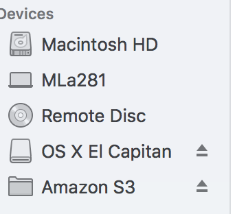

Hi @AT,
If all you need to do is access the S3 bucket / file system from your Mac I would use ExpanDrive (It is a commercially available utility).
ExpanDrive will allow you to mount the S3 bucket as it if were local to your Mac.  Once mapped you should be able to drag and drop files the same as with any folder or cloud based folder.Access AWS S3Access AWS S3

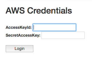

Thanks. I tried Open and did not work but I used Web(""); and it is now asking on user credentials since it is AWS S3. I have attached what is needed.
I appreciate anty further help.  Thanks

Thanks Stan. I will definitely give it a try and let you know.
