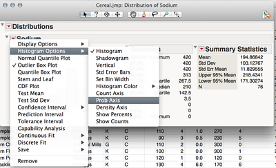

A relative frequency histogram has a y-axis that displays proportion of total rather than n. The guide above shows how to generate the histogram, but I don't show how to get the proportion axis. In the Distribution platform you can specify the type of axis displayed by selecting the Red triangle next to the variable name, then Histogram Options.
