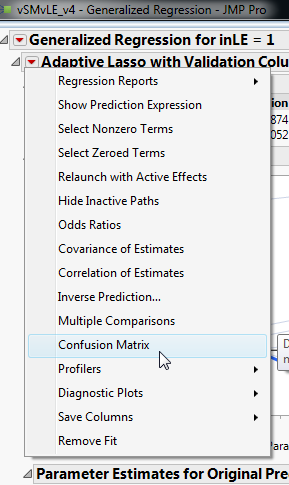

Also, I hope this helps. In JMP Pro, on the model output page, click arrow down in top left corner and select Confusion Matrix. Then open Set Probability Threshold in the appeared new section of the output. This will show a slider you can move to control Recall and Specificity. Unfortunately, it does not seem to calculate Precision and F1 score :( But, I like the dynamic slider for the table :)
Screen Shot 09-28-17 at 11.06 AM.PNGScreen Shot 09-28-17 at 11.06 AM.PNG Screen Shot 09-28-17 at 11.07 AM.PNGScreen Shot 09-28-17 at 11.07 AM.PNG
