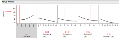

I constructed a dataset with 84 batches from various experimental designs (DoEs) in the development of a pharmaceutical drug product. After that, I built an ANN model to predict drug release. Now, I would like to predict drug release (functional response) using JMP Pro Functional DOE (FDOE) and compare with the findings to the ANN model’s.
  1. Does this comparison make sense? What is the best statistical method for comparing these two procedures (ANN and FDOE)?
  2. How can I choose the number of knots in the FDOE platform?
  3. In the FDOE Profiler (see picture) several formulation parameters resulted in negative drug release.  What does this mean? for some formulation parameters I obtained a negative value of drug release. Is this to imply that this FDOE approach may not be predictive of the first time points in my dissolution profile?

Please confirm that your response data are functions, perhaps a curve showing the progress over time of drug release for a batch.
Yes, it makes sense to compare myriad candidate models. You can use Analyze > Predictive Modeling > Model Comparison for this purpose.
Have you studied model selection in general or the FDE information regarding the number of knots?
The FDOE approach is based on linear regression. Regression assumes that the response varies between negative infinity and positive infinity. Your model might exhibit a lack of fit or bias near the limits of the response. You can use the FPCAs as the response with nonlinear models or any other model in JMP.

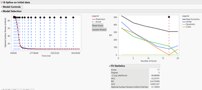

  2. In the FDOE platform, the number of knots is recommended by default when doing the analysis :
    When launching a type of model (B-Splines, P-Splines, Wavelets, ...) JMP will try a number of different knots size (which can be seen in the panel "Model Controls"). By default, JMP will choose a number of knots (and the degree of functions for Splines)  that minimize BIC (Bayesian Information Criterion), which is an information criterion that balances the predictive performance of the model with its complexity : the lower the better. Very often the range used by JMP will be sufficient to find a local minimum, but you can try to extend the range of knots number in the Model Controls to see if you're able to achieve a lower BIC :
    However, if you're increasing the number of knots closely to the number of (time) measurements for each batch of your datatable (like in the example above), make sure to use a validation set to avoid creating an overfitted model that works perfectly on this training set but performs poorly on other external data.
  3.  There may be a lot of things to check in the FDOE platform before commenting on the results of the model :
    - Which model did you use and why (B,P-Splines, Wavelets, ... ?) ? Have you used any preprocessing steps for your data ?
    - How much knots and which degree of the functions did you use ?
    - Did you use a validation set ?
    - What is the variability and reproducibility of your measurement process ? Are the errors of the FDOE too big compared to measurement variability ?
