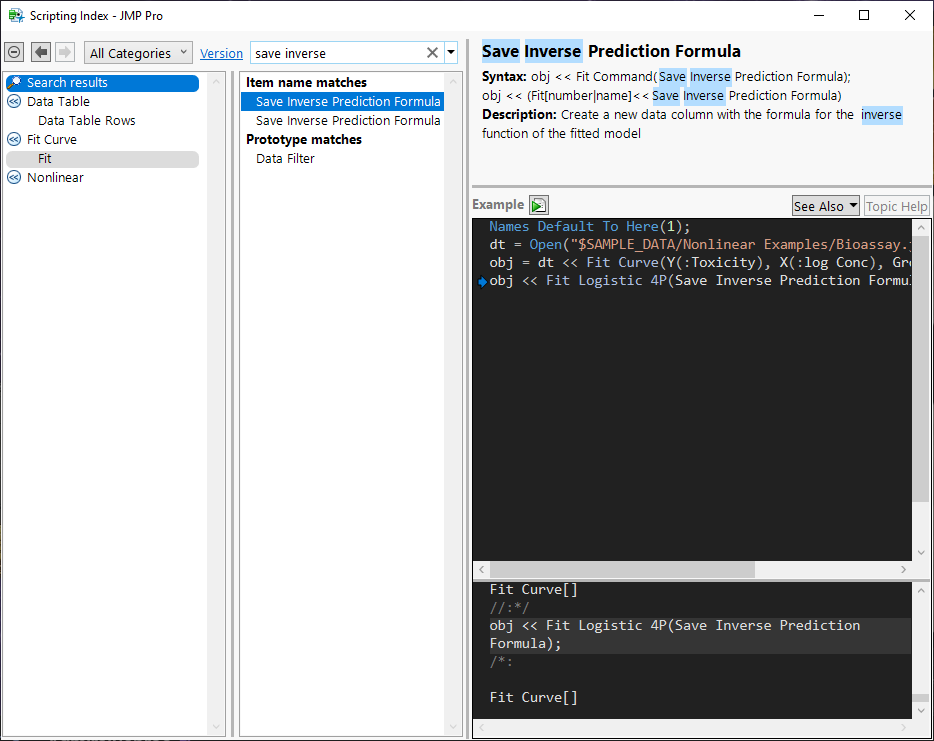

You might have to drop Fit Logistic 4P from your Fit Curve.
This is example from Scripting Index and it has Save Inverse Prediction Formula inside Fit Logistic 4P message
Names Default To Here(1);
dt = Open("$SAMPLE_DATA/Nonlinear Examples/Bioassay.jmp");
obj = dt << Fit Curve(Y(:Toxicity), X(:log Conc), Group(:formulation));
obj << Fit Logistic 4P(Save Inverse Prediction Formula);
but usually you can move those messages inside the platform launch message like this
	Y(:Toxicity),
	X(:log Conc),
	Group(:formulation),
-Jarmo

jthi
Re: Script for saving inverse prediction from fit curve into data table column
	Y(:Toxicity),
	X(:log Conc),
-Jarmo
