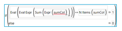

Dear Sir,
I am debugging an if statement like the one below.  I am wondering what does it evaluate on and if it would generate "1" from the unknown state of "(Eval(Eval Expr(Sum(Expr(sumCol))))== N Items(sumCol)"
Please let me know.

Strong suggestion to check out this great post about Insert one expression into another using Eval Insert, Eval Expr, Parse, and Substitute .
Names Default To Here(1);
sumCol = [1,1,1];
//check in parts
Show(Eval Expr(Sum(Expr(sumCol))));
Show(Eval(Eval Expr(Sum(Expr(sumCol)))));
Show(N Items(sumCol));
Show(If(Eval(Eval Expr(Sum(Expr(sumCol))))== N Items(sumCol),1,0));

Do you have any idea what you're actually trying to do?
My guess is you have a script making that and people tried to put in the variable `sumCol` into the formula.  with something like
Names default to here( 1 );
dt = open("$SAMPLE_DATA\Big Class.jmp");
sumCol = dt:weight << Get Values();
dt << New Column("test", Formula(if(Eval(EvalExpr(Sum(Expr(sumCol))))==Nitems(sumCol), 1, 0)));
// What I think you'd want to do is
Eval(EvalExpr(
	dt << New Column("Test 2", Formula(Sum(Expr(sumCol)) ==Nitems(Expr(sumCol))));
	// or
	dt << New Column("Test 3", Formula(
		fsumCol = Expr(sumCol);// this is just letting the formula know what it is
		Sum(fsumCol) == Nitems(fsumCol);
// you don't need the if, 1, 0 because you're boolean will eval to 1 anyway.
