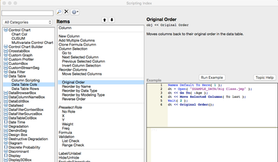

Re: A JSL script for moving columns to original order?
The best place to check out this kind of stuff is 'Help > Scripting Index', which usually has useful examples too, should you need them:
Clearly I need to use it more often myself . . .
