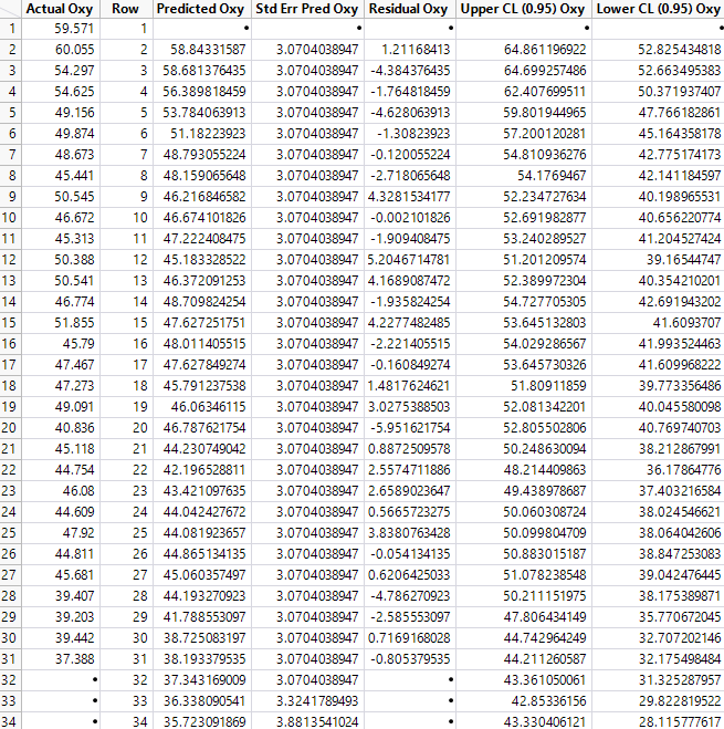

Re: 3-periods ahead forecasting with ARIMA/Transfer Model function
See Help > Books > Predictive and Specialized Modeling > Time Series chapter.
The launch dialog includes a number edit box for Forecast Periods. Enter 3 here for your case. Click OK, select the time series model, and then click the red triangle next to this model. Select Save Columns.
I illustrate these steps with the (inappropriate) Fitness data. I select Oxy for the Time Series role and enter 3 for Forecast Periods. I fit a first-order ARIMA model and select Save Columns. I receive these results:
As you can see from the example that I posted above, the answer is yes.
I received a prediction column with the forecast for the next period (1), the period after that (2), and one more period (3). All three periods (rows 32-34) beyond the last observed time (row 31).
Three numbers as provided by JMP Time Series would require trivial effort for manual data entry into separate data columns. Otherwise, you could use the Tables > Split command to do it.
Rows 1-31 are the actual (observed) responses used to fit the ARIMA model along with the predicted response. Rows 32-34 are the forecasts (predicted responses) for the 1st, 2nd, and 3rd periods beyond the observed data. So row 31 is last observation on Monday (in your example) and row 34 is the forecast for Thursday.
