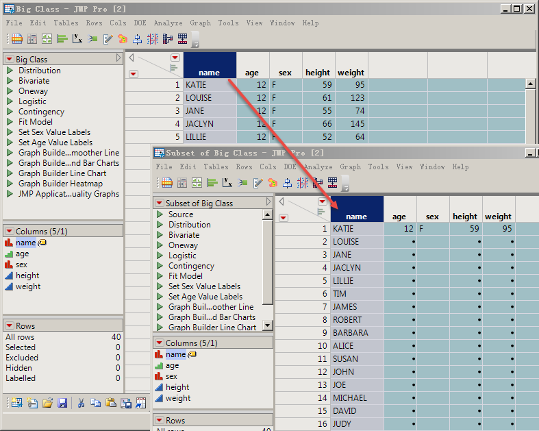

我按下面的脚本将第一列的带列名复制。
如何用脚本将复制内容到其他表中带列名粘贴?
dt << Clear Select();
dt << Select Columns( 1 );
Current Data Table() << Bring Window To Front;
Main Menu( "Copy With Column Names" );
dt << Select Where( Row() == 1 );
d3 = dt << Subset( Selected Rows( 1 ), selected columns( 0 ) );
Current Data Table( d3 );
d3 << Select Columns( 1 );
Main Menu( "Paste With Column Names" );
简单的问题、我却不能实现。谢谢!

Extracting the script from a column, creates a script that will recreate a new column.  If you want to move values from one data table into a column in another table, where the column already exists, you might want to use something like the code below
theValues = column(dt, 1) << get values;
d3 << add rows(nitems(theValues)-1);
column(d3,1) << set values(theValues);

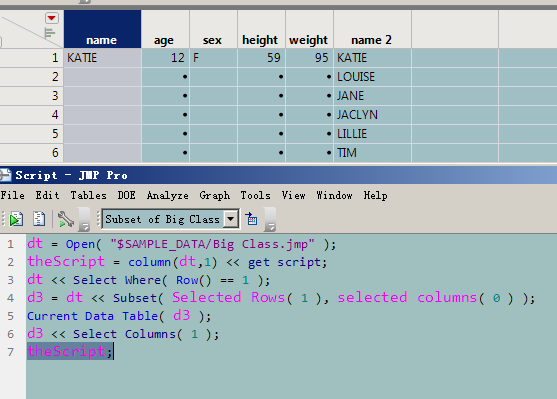

我试着这样修改代码、但它是创建新列来粘贴。
theScript = column(dt,1) << get script;
theScript;
