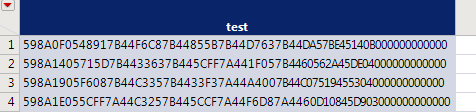

如何用JSL将没有分行的文本按字节数拆分为多行的表格?
请教专家:
如何用脚本将下面的文本、按每 64 个字符拆分为1行、
598A0F0548917B44F6C87B44855B7B44D7637B44DA57BE45140B000000000000598A1405715D7B4433637B445CFF7A441F057B4460562A45DE04000000000000598A1905F6087B44C3357B4433F37A44A4007B44C07519455304000000000000598A1E055CFF7A44C3257B445CCF7A44F6D87A4460D10845D903000000000000
得到这样的表格

Many was to do this and it depends a little bit how your strings look like (do they always have that long sequence of zeroes, is it always dividable with 64, how long it is).
Below is one maybe not so common way to do it by using Regex Match:
Names Default To Here(1);
txt = "598A0F0548917B44F6C87B44855B7B44D7637B44DA57BE45140B000000000000598A1405715D7B4433637B445CFF7A441F057B4460562A45DE04000000000000598A1905F6087B44C3357B4433F37A44A4007B44C07519455304000000000000598A1E055CFF7A44C3257B445CCF7A44F6D87A4460D10845D903000000000000";
splitCount = Length(txt) / 64; //amount of splits
regexPattern = repeat("(.{64})", splitCount); //create regex pattern to be used with Regex Match()
regexList = Regex Match(txt, regexPattern); //get list of splits
answer = Substr(regexList, 2); //drop first index, because it has the whole string (see scripting index for why)
//add to table
dt = New Table("test",
	New Column("test", Character, Values(answer)),
	New Column("lenght", Numeric, Continuous, << Set Each Value(Length(:test)))
